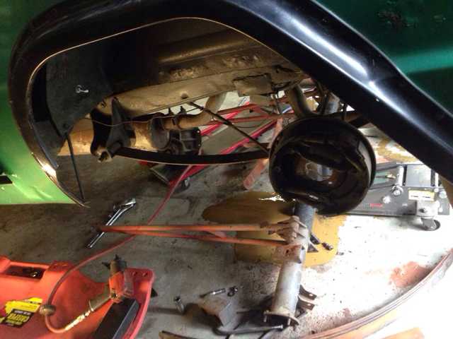

here's a pic from page 2 when i removed all the old stuff, looks like the new springs are installed right.
[Image: egary5yt.jpg]
#38
Springs are installed correctly. If they were installed the other way it should stretch the wheel base. Could be that they were installed the other way before. Who knows.
The lift blocks aren't helping things but something else is going on. I worked on one a few years back that bucked really bad on take off. It wouldn't do it in low range. Only high range when starting from a stop. It was the flywheel. With the price of new, I never resurface them. Could be the culprit still, not sure. What kind of clutch did you use, 3 finger style, or diaphragm style pressure plate?
A sloppy clutch linkage or bad motor mounts can cause these issues too.
One thought I am thinking is to see if it does it in 2wd low range. If it is a drive shaft issue, it might still do it??? Torque on the clutch itself would be less, but drive shaft should be seeing the same forces. My guess is it is still something with the clutch instead of the drive shaft.
#39
Nevermind on spring orientation. Just saw your latest post.
