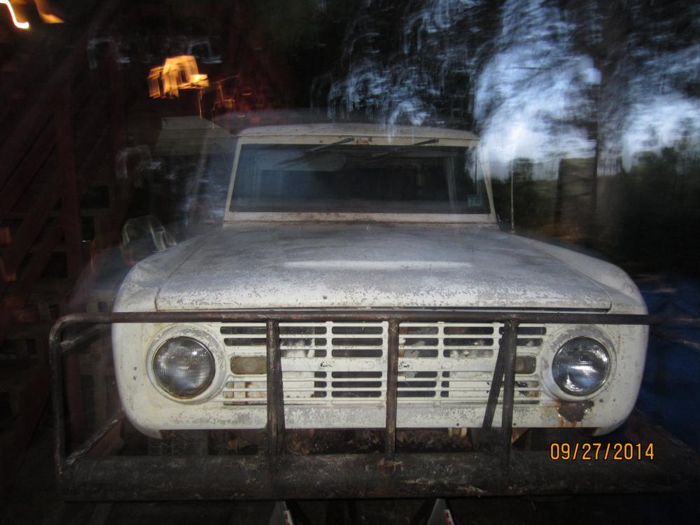

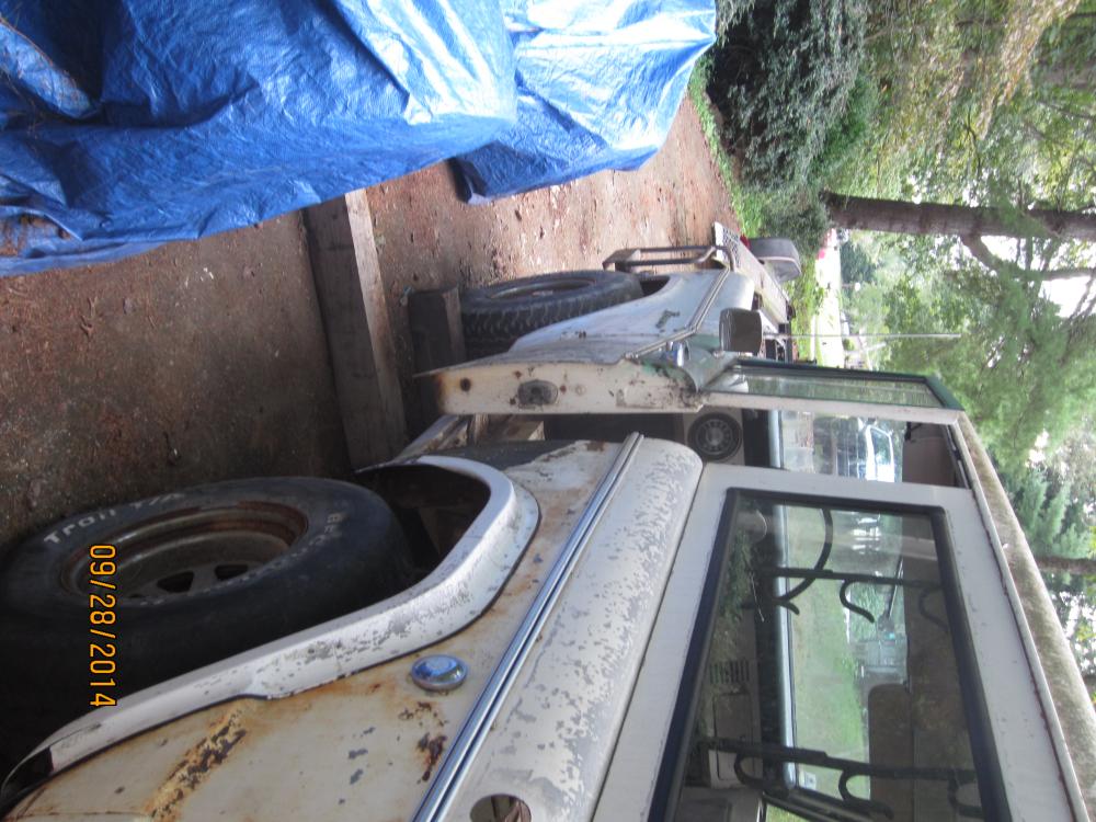

Ok so I pulled the triger on my first complete bronco, the others I have bought have been projects and I will get to them once this one is driving, wanted to enjoy driving one while I worked on the others. It is a little rough but after a little cleaning and a little metal work think it will be ok. So for pics I have been doing little things to it so far to get ready to get it on the road. When I went to pic it up one of the tires blew out before I got there when he tried to air it up so I brought a rolling tire and rim for it. It has been sitting for 15 plus years and even after putting the tire on it still wouldn't move brakes where locked up. So with a little help we drug it up the hill and got it on the trailer. So the first set of pics will be of it sitting in its spot on the mountain for the last so many years.
Ok so here are the rest of the pics of it sitting in its old home on the mountain
