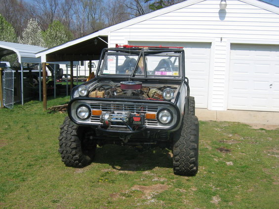

At the local meet @ godevil's 03/26/08 I had some issues with my headlights cutting off and on after awhile so I got some offroad lights mounted and put them on a toggle switch in case this happens on the road I won't get a ticket.
new lights with covers on

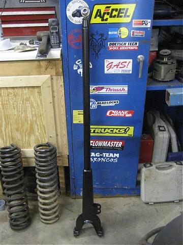

I built a new set of radius arms and installed some nice new dents in the body:hysterical:

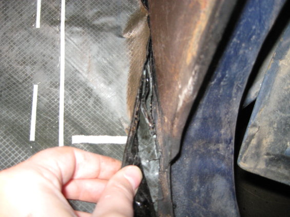

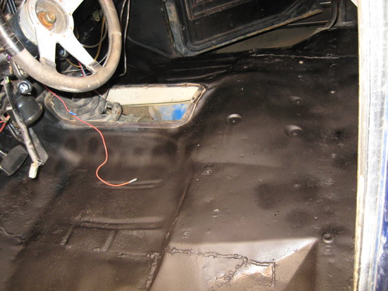

I've been waterproofing the 78 bronco...
After the floors were repaired I primer'd them
[Image: img_7116.jpg]

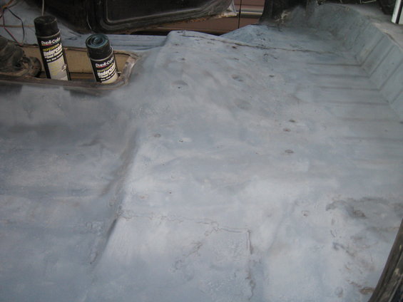

After that I did some sound deadener/rubberized coating to seal/waterproof and sound deaden the vehicle:
[Image: img_7122.jpg]
[Image: img_7123.jpg]

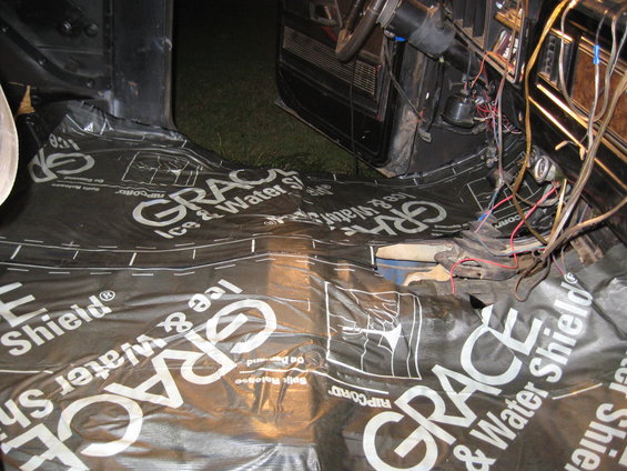

Next I added a waterproof membrane to the floor, very thick and permanently waterproof:
[Image: img_7138.jpg]

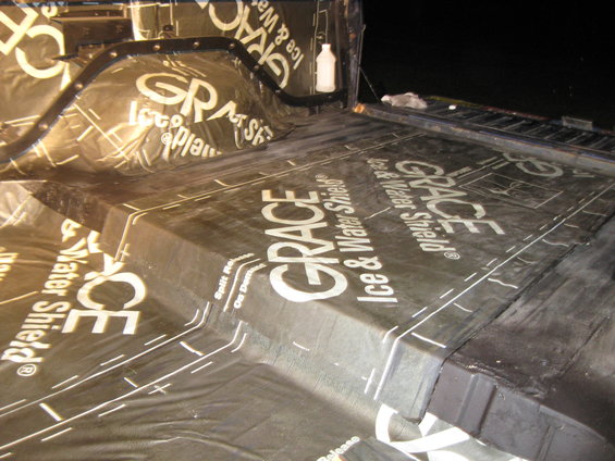

I double layered it in strategic locations to make the water all flow out of the truck instead of pooling anywhere:
[Image: img_7129.jpg]
I'm half-way done with the back:
[Image: img_7158.jpg]
Next I will put down the vinyl floor and install neoprene seats. I plan on keeping the top off most of the time. I've got one soft top for it, looking for a different style. :beer:
(I'm into this little project at over $370 bucks. Goodness knows it beats the floors rotting out)
