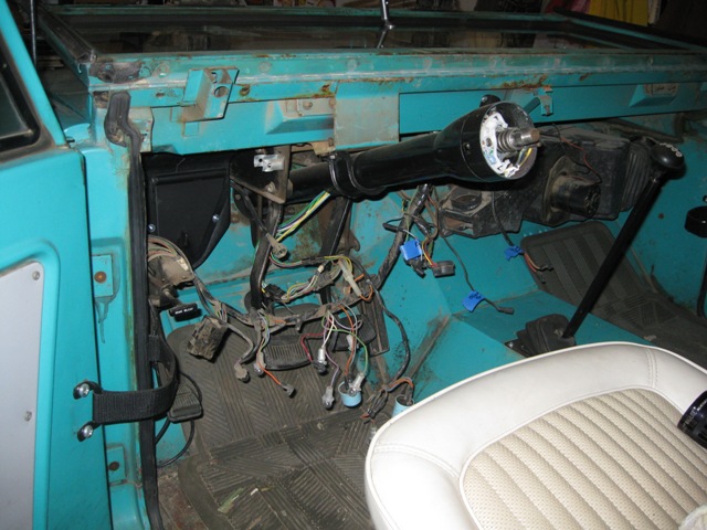

Although it looks like a mess, the wiring is in really good shape.
No cut up wires or hack jobs. Still all original. I'll clean up the wires and get
things reorganized, replace all the bulbs and the flashers and I'll be good to go here.

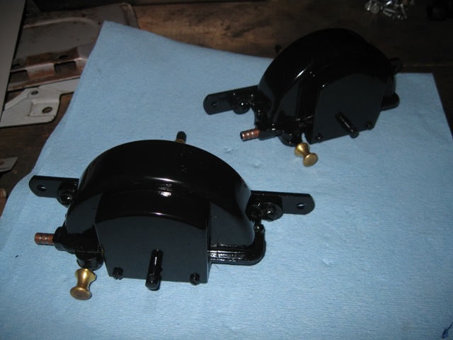

Sorry I didn't get any photos of the rebuild of the speedo and vacuum wiper motors. Here's a couple of the final results.
The speedo came apart easy but it was a bit tricky to get the odometer
set back to 000000, not hard, it just takes patience which I am sometimes
short of. I cleaned everything up, painted the needles on all the gages and
installed a new voltage regulator.
'66 note ... the speedo is a '66 only. If you look close the hash marks are
above the numbers. Later years have them below the numbers.
The vacuum wiper motors are interesting little machines. They have a wiper
plate inside complete with a leather sealing surface. They have a layer of
grease inside to help seal it. I completely disassembled them, cleaned the 43
year old grease out and soaked the leather seals in oil to swell them back up.
I regreased everything with multi-purpose bearing grease, carefully re-used
the old gaskets and reassembled everything.
They work great, I think. I tried to talk my wife into sucking on them but she turned me down so I did it. :xyxthumbs: They worked like a charm.
