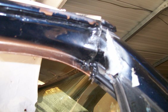

So, the first obstecle to overcome was whether I could make the window frames removable (Shane's idea, I was going to try and graph the inner section of the window frame to the body and to the T-Top so the window closed up against them. Shane's idea was better and easier).
[Image: 100_1893.jpg]

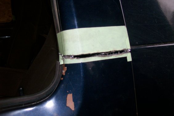

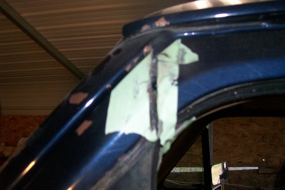

I tried to maintain the body line. (kinda silly to be taping off the paint considering it is peeling up everywhere).
[Image: 100_1894.jpg]
Here I added a plate to the top of the window frame on the door. It's hard to tell but I left a hole on the right side, where the post will go (you'll see in a minute).
[Image: 100_1898.jpg]

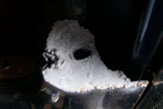

Here's the plate on the door, notice the hole on it. (I know, booger welds, but that's what a grinder is for).
[Image: 100_1901.jpg]
Here's the plate on the top of the removable window frame, with the post mentioned earlier. The post comes from a heavy-duty door latch. With some grinding, it fit into the hole in the window frame still attached to the door perfectly!
[Image: 100_1902.jpg]

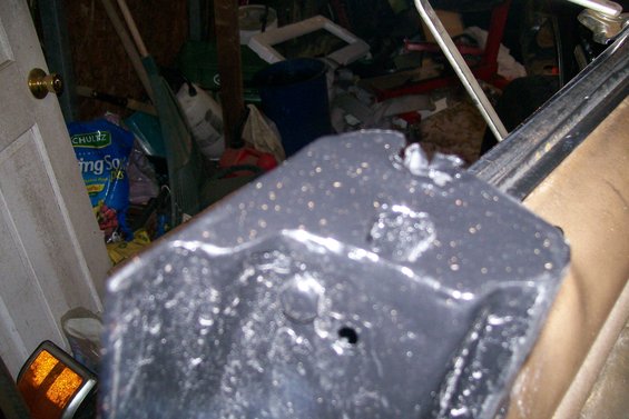

Plate and post on the bottom of the window frame. In that hole in the earlier pic, where the plate is over the door, I graphed in the receiver that the post was designed to go into. It helps stabilize the frame once it slides down in there.
[Image: 100_1903.jpg]
Here's the point of no return, once I did this, there was no option but to finish. Now, keep in mind, I already did this to a parts truck, so I knew what to expect and had a good expectation that everything would work as I wanted it to.

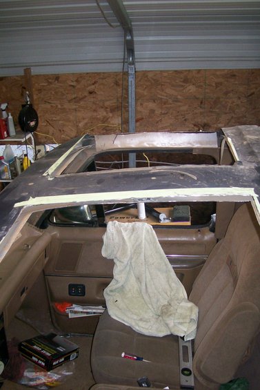

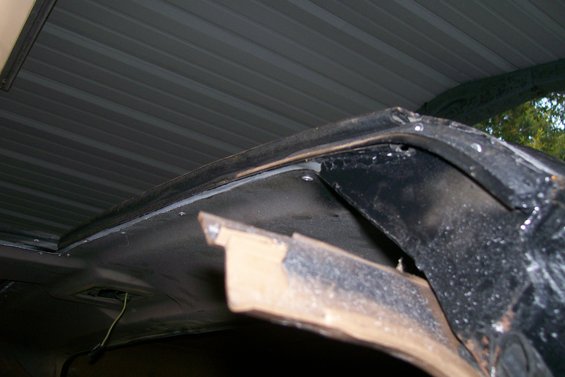

All out. I left the part of the roof where the door closes against it for measurement purposes when it came time for the Lexan.
[Image: 100_1914.jpg]

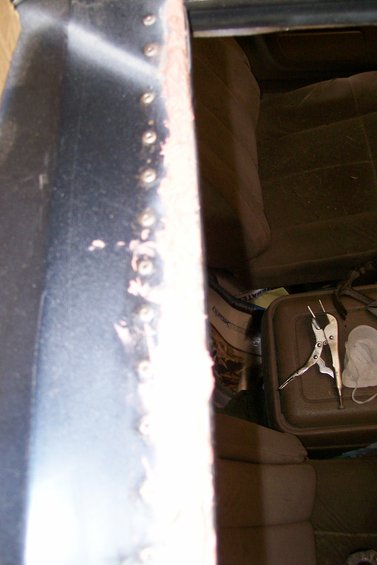

I decided on pop rivets because it wasn't as permanent as welding, and the welding wasn't coming out as clean (I tried it on the parts truck).

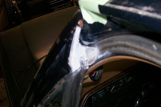

My first attempt at bondo.
[Image: 100_2106.jpg]
[Image: 100_2108.jpg]

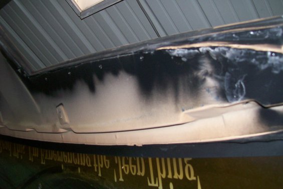

So, I cut the remainder of the roof out.
[Image: 100_2112.jpg]
[Image: 100_2113.jpg]

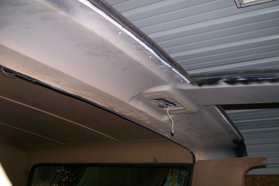

I started plated in the rest of the body.
[Image: 100_2137.jpg]
[Image: 100_2138.jpg]

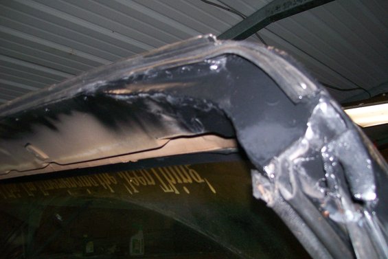

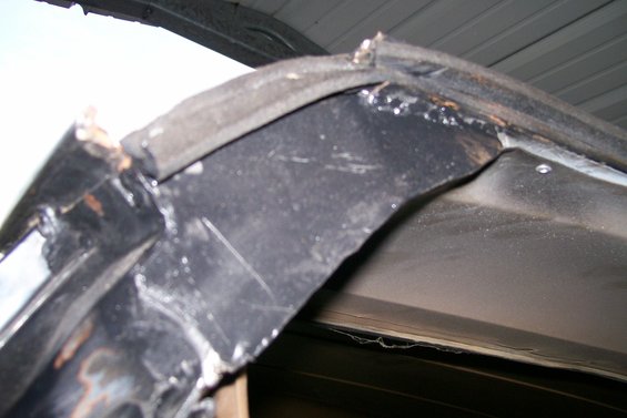

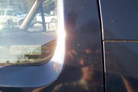

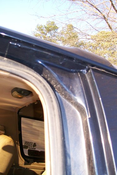

Here's some finishing pictures. Notice I redid the seal so it extended out to the outside of the door.

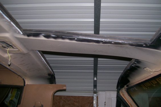

[Image: 100_2699.jpg]
[Image: 100_2701.jpg]

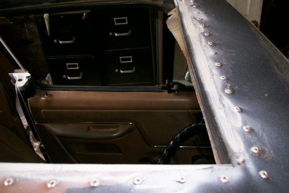

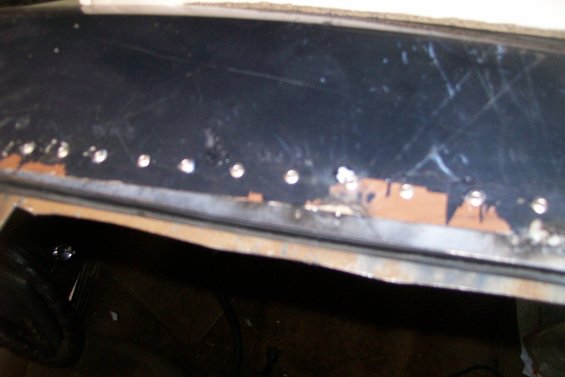

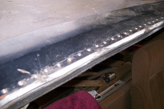

I riveted the inner roof to the window guides.
[Image: 100_2702.jpg]
[Image: 100_2703.jpg]
[Image: 100_2704.jpg]
[Image: 100_2708.jpg]
[Image: 100_2709.jpg]

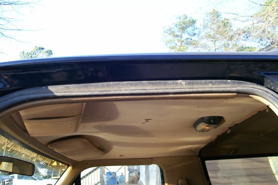

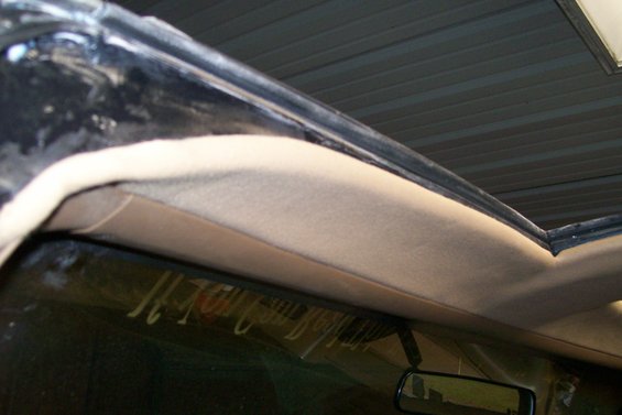

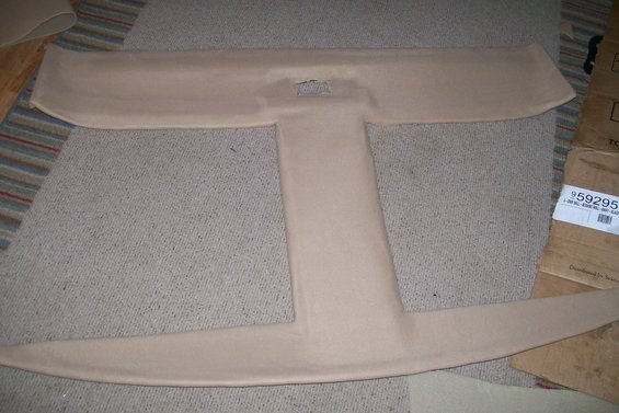

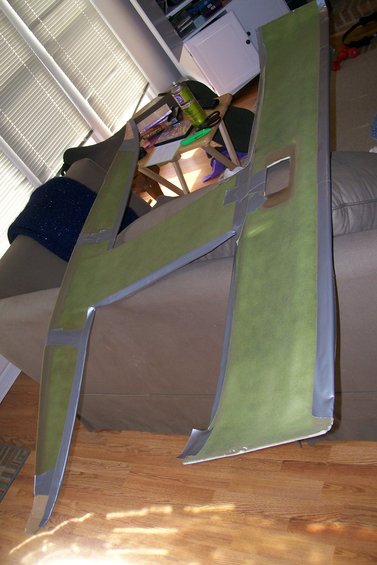

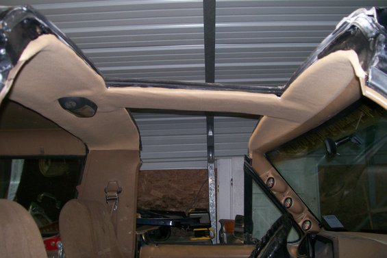

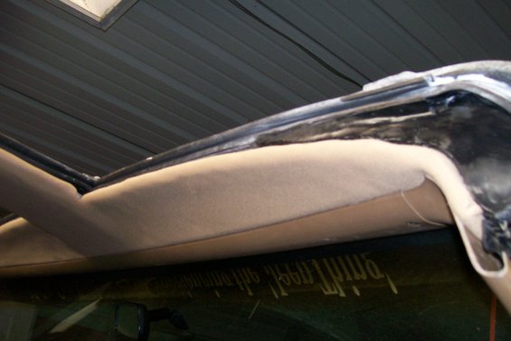

Here's the headboard. Much harder then the Cent's headboard. It's foam, and broke into 4 different pieces plus I had to rebuild the corners. Notice all the duck tape.
[Image: 100_2713.jpg]

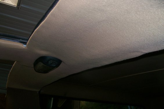

Here's the fabric all on.
[Image: 100_2714.jpg]

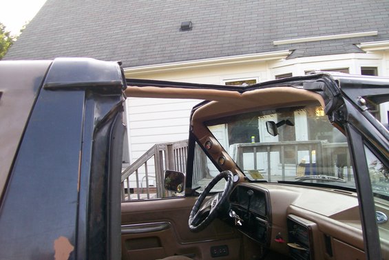

carefully mounted into place.
[Image: 100_2715.jpg]
[Image: 100_2716.jpg]
[Image: 100_2719.jpg]
[Image: 100_2721.jpg]
[Image: 100_2722.jpg]

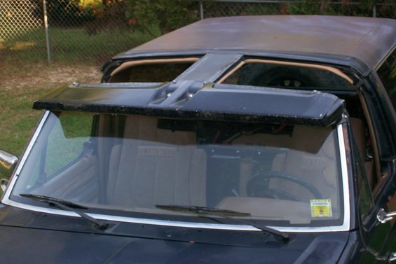

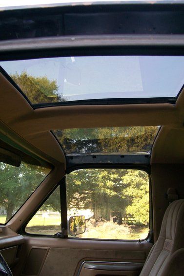

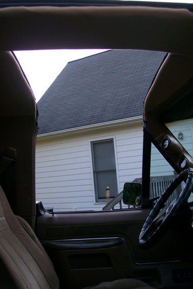

So here's the finish product, I'm very happy with the outcome!
[Image: 100_2723.jpg]
The lexan is attached to the roof section the door closes against so they go in and out together.
[Image: 100_2724.jpg]
[Image: 100_2725.jpg]
You can see here, the back of the roof that attaches to the Lexan. I'm going to create some trim to cover those holes, and I'm also planning on attaching latches that will allow me to anchor those parts of the roof to the rest of the roof, this will allow me to position them exactly where I want them in relation to the door when it is closed.
[Image: 100_2726.jpg]

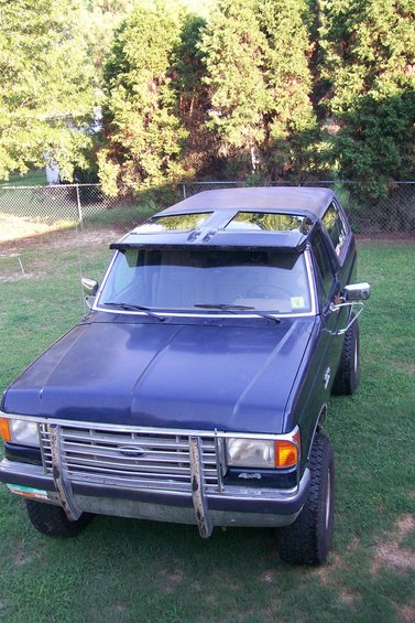

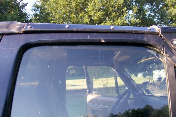

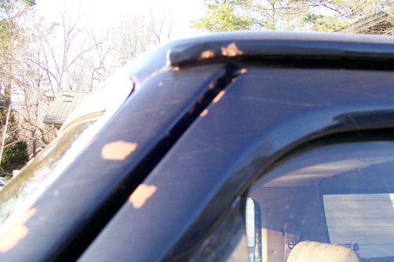

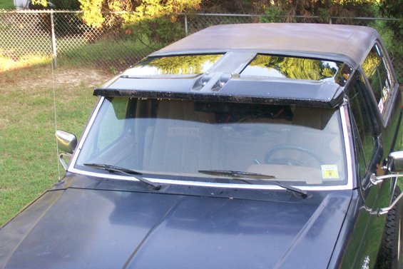

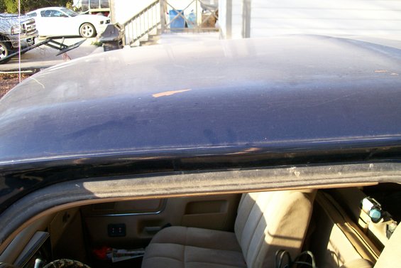

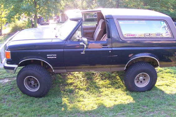

From the outside (yes I know the moon visor is crooked, I need to redo a bolt or two to get it straightened out).
[Image: 100_2727.jpg]
[Image: 100_2728.jpg]
[Image: 100_2729.jpg]
[Image: 100_2730.jpg]
[Image: 100_2731.jpg]
[Image: 100_2733.jpg]
[Image: 100_2734.jpg]
[Image: 100_2736.jpg]

Funny you should ask, I drove it to work today and I think they're calling for rain. I had a couple of leaks at the corners where the tops meet the inside part of the roof once they're secured. I used some silicon in the corners, that atleast passed the water-from-a-cup test.

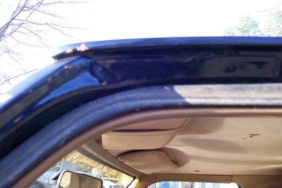

I still have a problem where the lexan bends down to the door. There are gaps there between the lexan and the window guides I used. Lexan is very, very hard to work with, so the bends are not perfect to the line of the guides.
This pic shows the areas I'm talking about.
You notice I had to trim off the top part of the window guide since the Tops have to slide in, there was no way to have the curved part of the Tops be completely sealed top and bottom. I was thinking on my way in on how to seal that up, it's got to attached to the lexan (if it's attached to the truck, it would obscure the top from sliding in). I have to play around with it and see what I can come up with.
The good news is, I don't think it's going to let in that much water, if any, since the seal is still below it. The only problem is, it creates wind noise going down the road.
