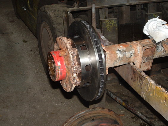

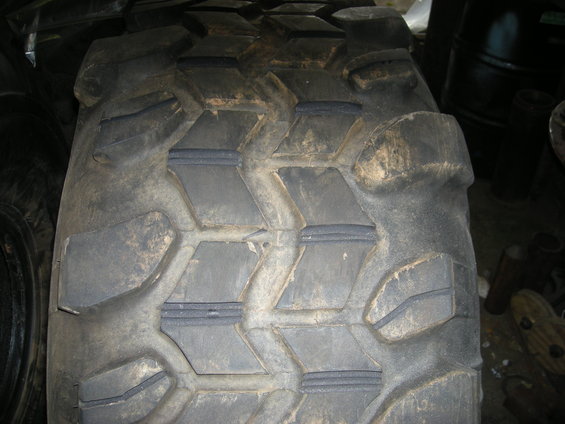

my 1 ton build
i've always wanted a big truck. my dad and his buddys all had'em so i started with a 79 xlt bronco i picked up in nov. i put 4.56 and l/s f/r to clear my 35"s. then i found my front 60 and picked up a 14 bolt for song. i got 5.38's and detroits front and rear. i'm gonna run 44's when it's all done

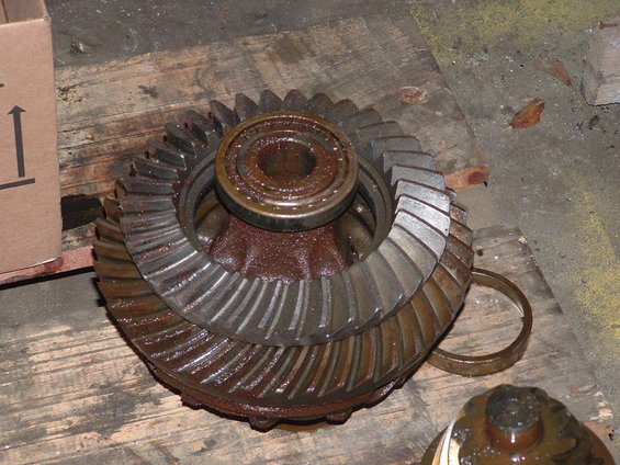

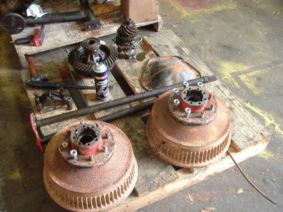

9" vs. 14 bolt

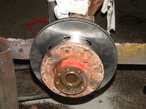

[Image: pics-054.jpg]
[Image: pics-047.jpg]
[Image: pics-058.jpg]

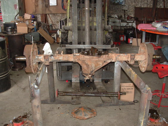

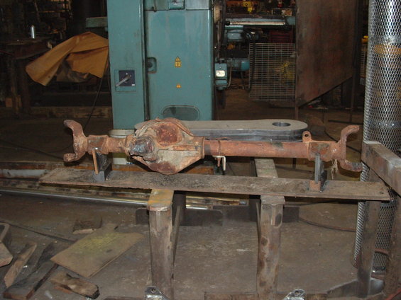

my jig and the donor 44 with the welded c's

nice build up. keep the pics coming.
yeah i did'nt get as many for the front as i wanted to. I've built the axles at work when i had the time. i've almost done with my high steer arms. just one of the perks of workin in a machine shop.
What are you going to power that beast with??
General Jon
right now it's a 400 but it will be replaced with a 460 or 514. just dependes on the funds

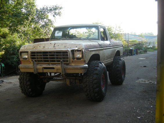

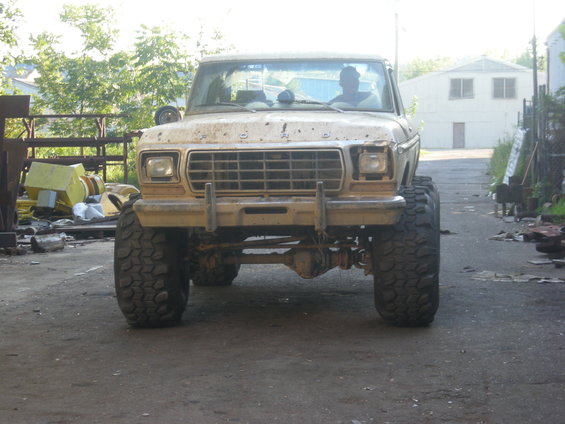

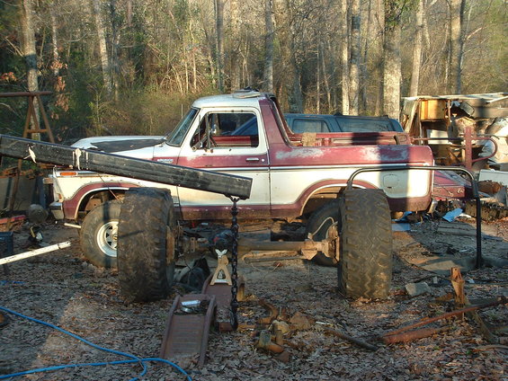

[Image: th_eddy2029%5B1%5D.jpg]
this is the what i started with, after i put a 4" lift and 4.56's

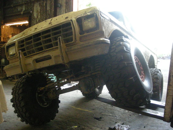

It looks like you have a great shop too! Can't beat a forklift when needed :xyxthumbs:
