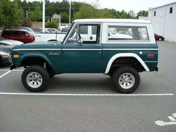

Perfect. Thanks for the input. Now I need to get a bigger hammer to try to get out the track bar bolts so I can change out the bushings. Here is a pic with the lift on....new tires are coming next when the funds are available.
[Image: picture-076.jpg]
LOOKS GOOD.. SETS GOOD TO... NEED MORE MEAT:biggthumpup:
