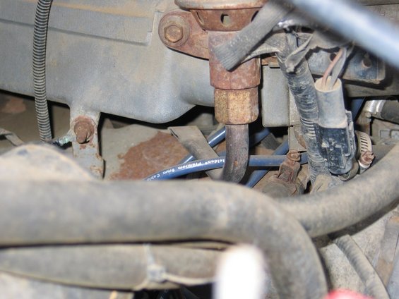

Traveler Wrote:Not that I would ever do anything like this, but I have heard of guys taking the egr loose and putting a quater behind them to block them off. I've had it off before... no such luck. broncomatt Wrote:ford bronco mpfi fuel press spec 35-41psi I'll go check the PSI now, the EGR tube is brand new. The old one was cut off and crimped about 2" from each end.

Ok, PSI at idle is 30-31 PSI. At 2400 RPM same 30-31 PSI, but if I goose the throttle to get there it drops to around 27-28 PSI and slowly raises back up. Same 30-31PSI up through 4000 RPM.
EDIT: You can see here why I had to replace the EGR tube. The new one probably has about 20 or so miles on it currently.
