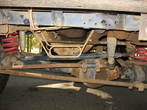

For steering, I used (new) stock 78/79 left & right tie rod ends and a 1995-ish F350 4x4 drag link. I reused the drop pitman arm from my Rough Country lift.
[Image: img_0779.jpg]
The trac bar is the Superlift adjustable model.
[Image: img_0794.jpg]
For the upper trac bar mount, I reused the lower 1/2 of the stock trac bar mount. I test fit it to get the proper angle, and then cut the mount to the correct length. It's welded to the bottom of the frame with a couple of gussets and a brace that is welded to the engine crossmember. It's not pretty, but it works.
[Image: img_0796.jpg]
And here it is back on it's tires again
[Image: img_0798.jpg]
And that's it in a nutshell. Hope this help someone...if nothing else, it kept you from actually having to do work for a couple of minutes :xyxthumbs:
