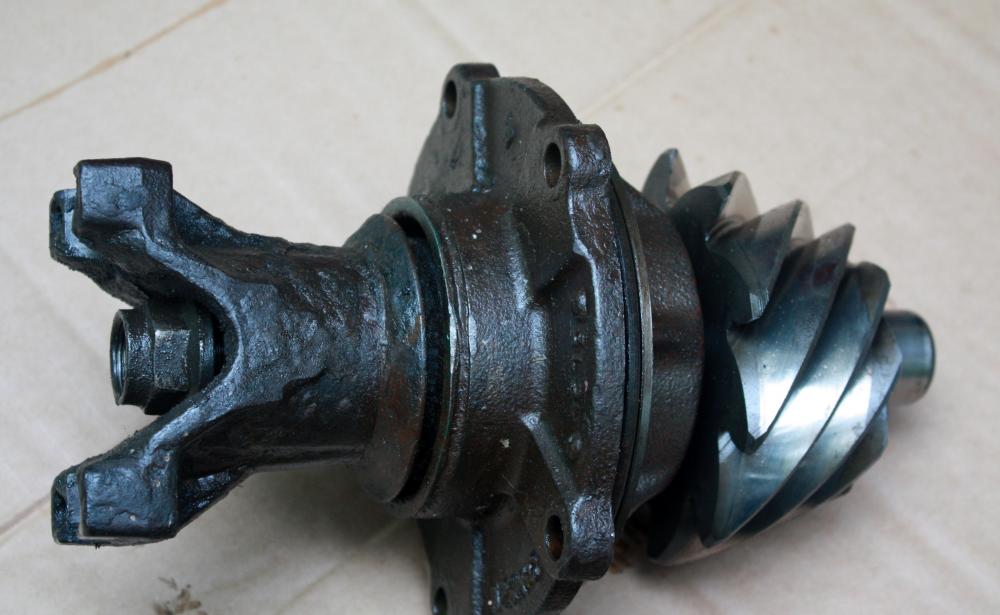

Shoot us a pic of the setup as it sits and we can yell you what may be needed to get it in for Tellico
Here is what I have. This is like this because I let someone I know who said they knew how to swap out the chunk help me. They started at the drive shaft and undid every bolt they came to till I stepped in and stopped him. I know that at the least I will need a pinion seal, from there I am not sure.
[ATTACH=CONFIG]8646[/ATTACH][ATTACH=CONFIG]8647[/ATTACH][ATTACH=CONFIG]8648[/ATTACH]
Looks like you MAY be good to just drop the 3rd and pinion in and roll with it.
IF the four carrier bolts and the pinion nut were not touched, you can rest assured the setup is sound.. The teeth look pretty good though.
Wait, I don't see a shim on the pinion support. If you are certain there wasn't one to begin with, you are fine.
It would have been a metal gasket looking deal that goes between the pinion support and the 3rd.
The 4 carrier bolts on the 3rd were not touched. The bolt on the end of the pinion was taken off it is just hand tightened in the picture. As for the shim, it was in the bottom of the box so I have that.
Okay. You can still make it work just be extra careful not to OVERtorque the nut since we aren't sure if you are running a crush sleeve or a spacer. I suppose it would be easy enough to check but either way, torque is important (i.e. don't use a flippin impact wrench). Since it is already loose, you can go ahead and change the pinion seal too.
