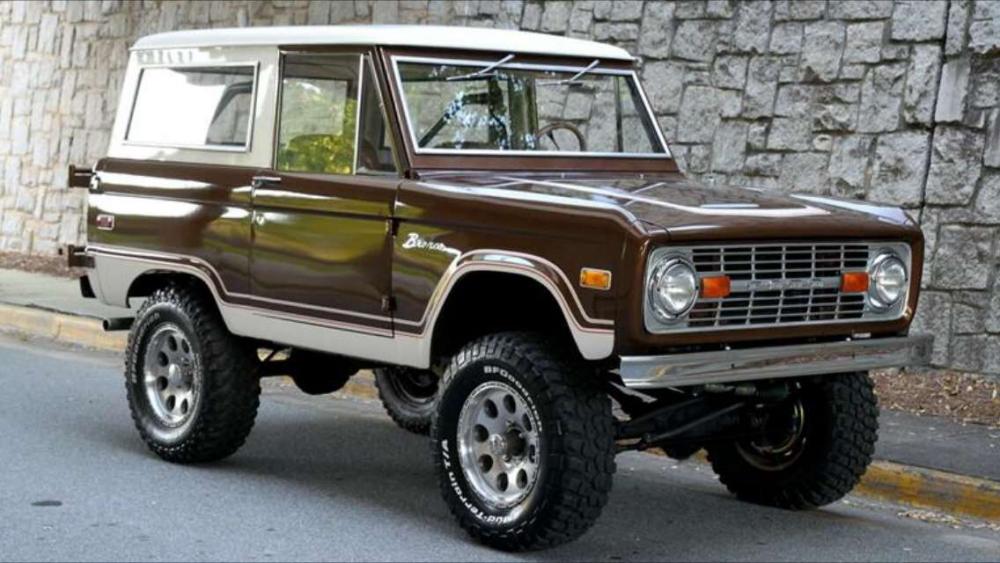

Here's where I need some input from you guys. The bronco has 3.50 gears. I'm committing to not cut or trim the fenders. I want to lift this bad boy but I really want this thing to handle like a champ. I'm currently thinking of putting a 3.5 lift on it with no body lift. I want this bronco to look bad ass but with the gearing I don't feel like I can go over a 32" tire. Crawdad told me earlier today that a 32x9.5x15 tire would work but again I'm not sure that's going to fill the front wheel well enough for me to be satisfied. The last one I built (pictures below) had a 5.5 lift and I love the way it set up but it drove like crap over 50mph. It had 33" tires with 17" wheels.

My question to you is why in the world did you get rid of that LUBR in the second pic?!!! That is freagin beautiful!

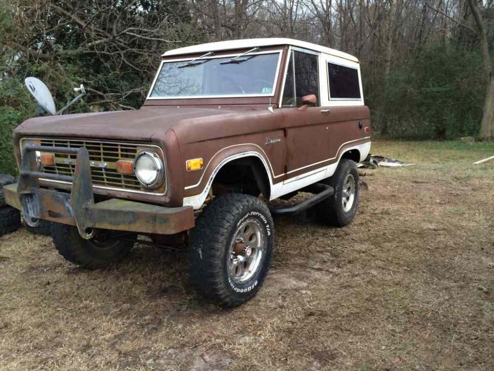

Everything I have is always for sale... For the right price. It really is a nice bronco. I found it in bamberg sc and it was the cleanest bronco I'd found in SC/NC/Ga. Had this one taken all the way to the bare metal.
This was my starting point:
The guy who bought it from me owns a classic car dealership.
I hate you........ You've done well Luke Skywalker!
