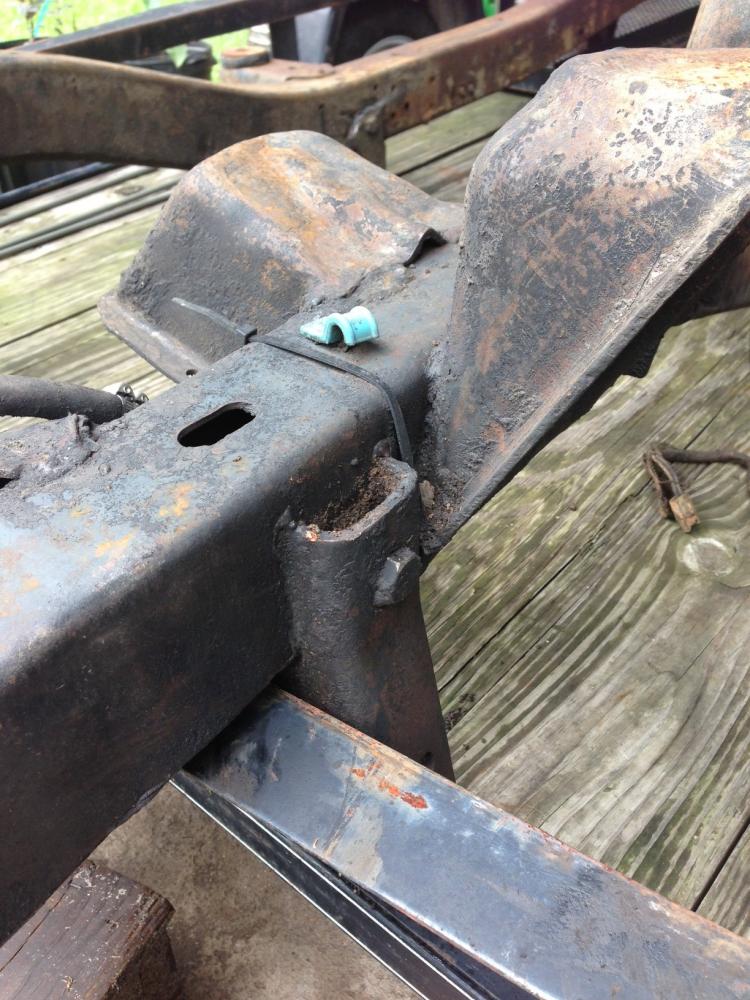

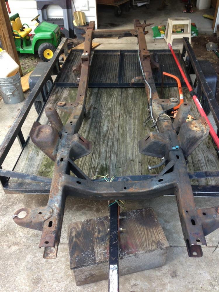

Got the frame delivered to my house so I can start my build. Will be doing some work on the frame such as smoothing the sides from all the rust pitting, fill in some unneeded holes, re-weld some areas, strengthen the PS box area, and whatever else you guys think. My plan is to have it galvanized in about three weeks. I have a company in Columbia who will coat it for $100 so I want to hurry up and get it done before they change their minds. I will have to sign a waiver in case the galvanizing process warps the frame. I don't think it will warp considering several guys on Classic Broncos have had it done, including NicksTrix. I've sought out his help and I truly appreciate his expertise. Once galvanized I plan to paint it using the KBS 3 Step Kit for less than $100. I plan to take great care to preserve the VIN stamps.

Not yet. Worked on it some today, still pulling wire wheel shrapnel from my legs and arms. Lots of oil and dirt inside the frame, a bear to get out. Waiting on some consumables to come in so I can do some welding.

Just cleaning most of the scale and easy rust. Then I'd like to sand down some of those booger welds. The first step of the galvanizing process is an acid bath to removed rust and other crap. I figure if I clean it some the process may turn out better.
