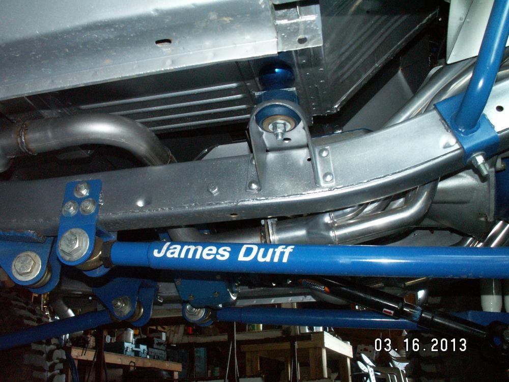

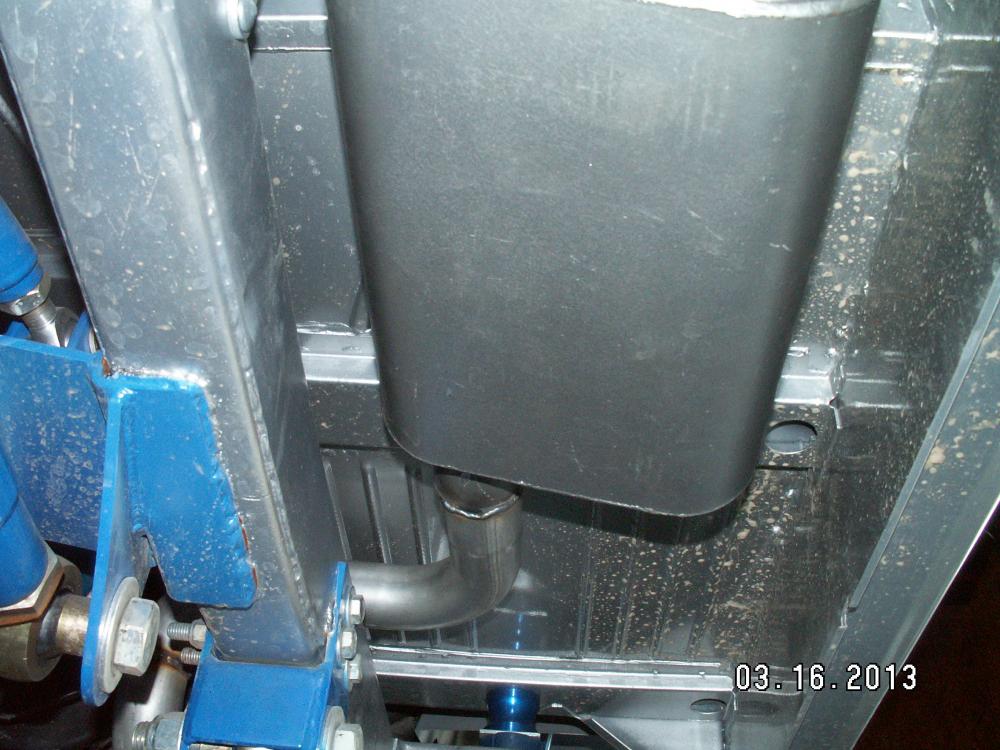

[ATTACH=CONFIG]7055[/ATTACH][ATTACH=CONFIG]7056[/ATTACH][ATTACH=CONFIG]7057[/ATTACH][ATTACH=CONFIG]7057[/ATTACH][ATTACH=CONFIG]7058[/ATTACH][ATTACH=CONFIG]7051[/ATTACH][ATTACH=CONFIG]7051[/ATTACH][ATTACH=CONFIG]7052[/ATTACH][ATTACH=CONFIG]7053[/ATTACH][ATTACH=CONFIG]7054[/ATTACH]
Anyways this what ive got. Dont laugh at those welds. I did not take my time and my welding instructer pa in law had to take a nap. Plan is to make sur I dont have any leakes, clean and VHT black.

Looks familiar!! Nice job...I'm sure Chuzie will approve

Beautifully done. Just a FYI guys we used the Cherrybomb exhaust builder kit on Loco. CB kit comes with flex couplers which will allow you to solid mount the exhaust to avoid it rattling around. Here is a link and this place has great prices.

Wow nice set up looks great

thanks dudley!! thats a nice kit...i just ordered a kit from speedway...it was about $30 cheaper...but did not come with flex couplings or 2 U bends. wish i had seen that kit sooner...ill keep it in mind now.
