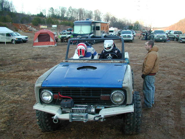

Some of you might recall seeing this rig before. It started out as our racer for the first race of the 2011 ECORS series. I didn't have the race rig done in time, so we went up to Asheville and brought this thing home the day before the race!!!
It did us well and ran great! Specs are a rebuilt 302, NP435 trans, spooled rear axle, 3.50 gears, ps, pb, front discs, and a few other things.
The tub was absolutely shot. There was enough fiberglass in it to have built one nice boat, or maybe 2 Bayliners... As the race progressed, the driver's side would buckle when the clutch was pushed in, and it got hard to make the truck shift!
It was a kind of "one (race) and done" thing.

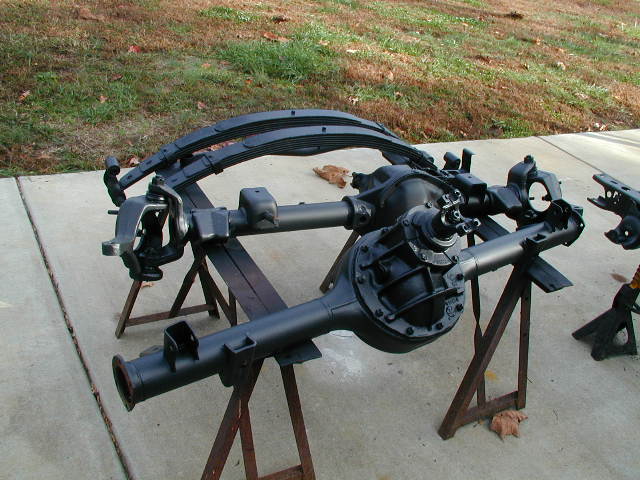

I cleaned the frame up, primed and painted it and the axles as well as almost every drivetrain part. It is a lot of work, but the end result will be worth it.

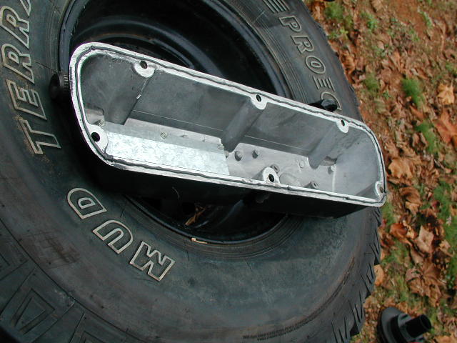

Well, there are a few more pics I can show. Here is the 302 all painted up. I put a set of alum valve covers on it yesterday. Figured I'd show a trick on installing these, if ya didn't know it already.
First, I don't use cork gaskets. Only rubber ones. They seem to not compress or deform as easily. The valve covers I used didn't have any retainers built into them, so the gasket is able to move around unrestrained between the bolt holes. Not to mention that the gasket itself is flimsy and not shaped perfectly.
What I do is I put a THIN bead of RTV on the cylinder head and place the gasket on it and finger tighten bolts against it to keep it in place while the RTV dries. Meanwhile, I cleaned up the valve covers. When the gaskets on the cylinder head are cured enough to not move, I remove the bolts holding them in place. I then put a thin bead of RTV on the valve covers and put them on the gaskets and bolt them all (finger tight) in place. Then, let it sit overnight and tighten the bolts the next day after everything is cured. Tight on a valve cover isn't very tight though. I find that a stubby ratchet is all that is needed. Voila, no leaky valve covers.

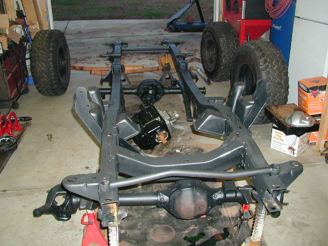

Got another couple of pics of it. Here is everything kind of laid out getting ready for re-assembly.

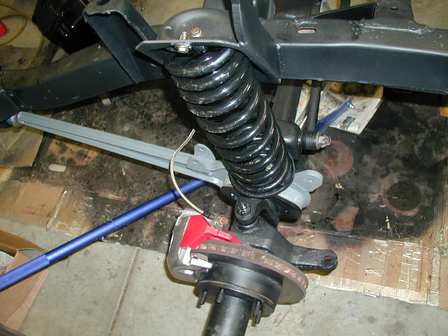

Got some more work done, though not much. All kinds of new parts going in the front axle...

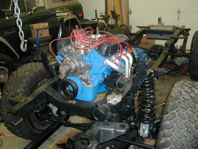

A few more pics. The engine/trans/t-case, is in. Headers are on. Kinda slow going- got a lot on the plate.
