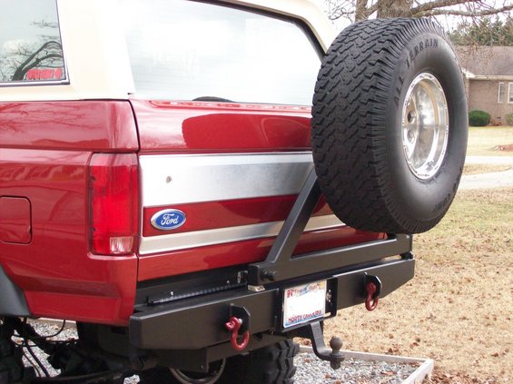

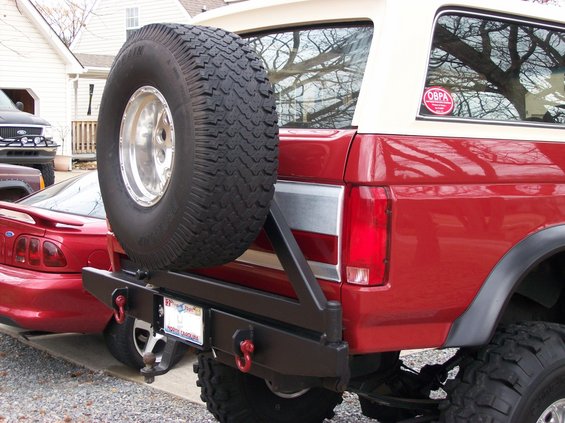

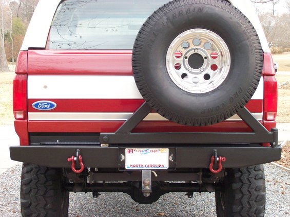

Just finished this for my sons Bronco.
![[Image: bumper_1.jpg]](http://www.supermotors.net/getfile/844319/fullsize/bumper_1.jpg)
![[Image: bumper_2.jpg]](http://www.supermotors.net/getfile/844320/fullsize/bumper_2.jpg)
![[Image: bumper_3.jpg]](http://www.supermotors.net/getfile/844321/fullsize/bumper_3.jpg)

thats pretty sweet, what did ya use for the pivot and lock?
01-03-2011, 10:38 AM
blazinchuck Wrote:thats pretty sweet, what did ya use for the pivot and lock? Pivot is a axle end. Lock is hard to explain It's a grade bolt welded to some Dom Tube and a lock.

anthonysmilsurp Wrote:I need one of those myself! looks real good, hope he likes it......if not I'll make a road trip up there Sorry but he loves it. My son is at Fort Bragg so if you can sneek on and get by his M4 and the PitBulls you may be able to get it off his truck.:hysterical: medwards01 Wrote:John, that is a sweet setup....did you build the bumper also? So, when did you say you can be in production because I'm 3rd in line behind J.T. and Anthony!! :xyxthumbs: Thanks but don't know if i can build them and cover my time (if i could make $100-$150 per bumper i would). I have around $250 in materials and need to pay a friend to do the heavy welding. My welder is only for the small things and tacking everything. Yes, i built everything on the back which replaced the step bumper.:biggthumpup:
