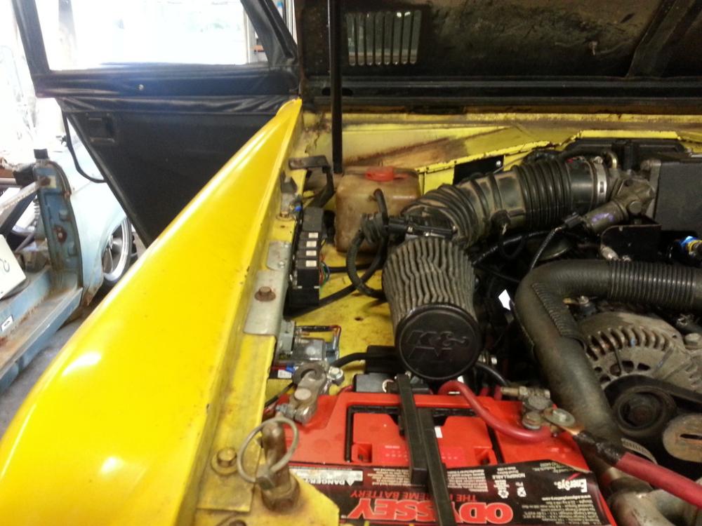

So all the wiring took about 120 hours!!! The engine runs great, all my systems are functional and the wiring looks amazing; mostly because you can't see it.
Everything was weatherpacked, soldered, heat shrinked and loomed. I do have a few stragglers at the rear of the frame for rock lighting that I will need to tidy up at some point. You may see a stray grey wire near the firewall in the engine pics. That was the VSS (vehicle speed sensor) splice I made to the EEC to test the cruise control. Fortunately I received the needed terminal pins today in order to integrate that wire into the main harness and it is now invisible.
There are 7 relays on the passenger fender. 4 control the EFI, 2 control my fan system and 1 is for the Hellas.

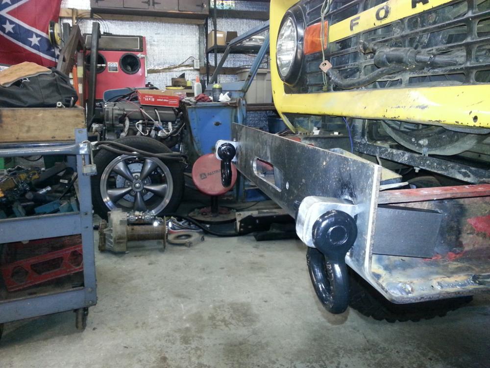

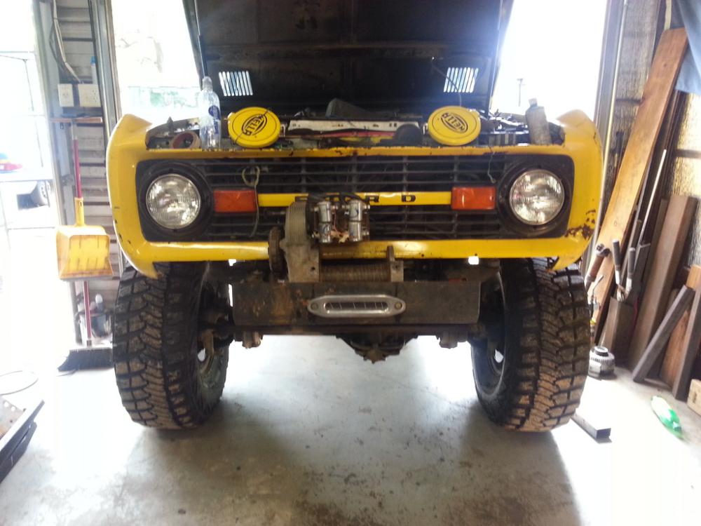

Then next big project is my new front bumper. Chuck and I modified an old Warn winch bumper a few years ago to work with my 8274 winch. Unfortunately, the "wings" were not reinforced and I have a bad habit of hitting trees, rocks and vehicles. My grill and quarter panels have been damaged by the bending of the bumper and we decided it was time to upgrade to something that was indestructible and matched the awesome rear bumper we made a few years ago.
The main plate and channels to the frame are 1/4" and all the reinforcement plating is 3/16". All the plates were cut at a local shop via plans from Classic.
Once Chuck welded the channels to the main plate, we had to stop as I forgot to order the 1"x2" flat 1080 steel to make the recovery tabs. We couldn't go further since the tabs will be welded to the main plate and inside the frame channel mounts.
[ATTACH=CONFIG]9134[/ATTACH]
[ATTACH=CONFIG]9135[/ATTACH]
Today the 1"x2" steel arrived. Each piece is 6" long and will accommodate a 3/4" shackle with a 7/8" pin. I spent a good bit of time drilling the 1" hole and shaping the steel. Here is a pic of the tabs slaved in. Tomorrow we plan to start welding and hope to finish.

Got a lot of the bumper done last night. Ran into a few snags with the bottom plates not fitting correctly. This is what happens when you use unverified plans from an online source.
No big deal though; just had to make some additional cuts to fit them correctly. Got it all welded up and ready for grinding and paint when I return to Charleston on the 18th.
I will say this bumper is pretty sick!!
