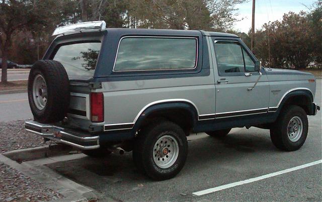

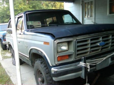

Well, got it together and running, havent dodged the cops yet to see if the tranny shifts. Pulled the pan on the C6 and just like the guy told me, it was rebuilt! Six years ago! The valve body is a hunk of rust and I had to clean up the 2nd gear drum, luckily I have 4 C6s in the yard for spares. Put the best valve body in and it pulls around the yard. Had to replace the fuel pump and blow out the fuel lines. I cranks up and sounds good, to me, its loud! Now I need some tires and exhaust then I am ready to hit the trails. Anybody got some old 33 x 15's they wanna let go cheap until I can buy some new BFG's? :rebel:
Here are some picts of the Bronco
nice looking bronco!
Sweet. :xyxthumbs: Like'n the swampersConfusedmokin:
