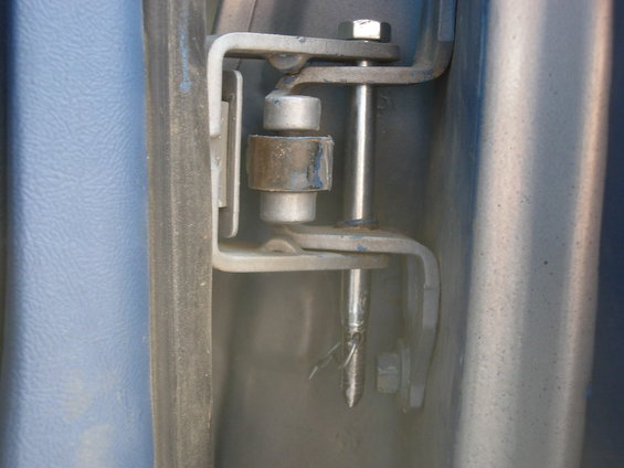

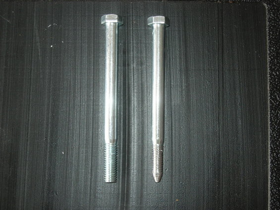

ive done this. all i did was cut the pins out the stock door hinge. its been a while and i cant remember what size bolt i used, but i had to drill out the holes a little bit to get the new bolt to fit. then i just bolted it back up and aligned the door. i can get pics tommorow.

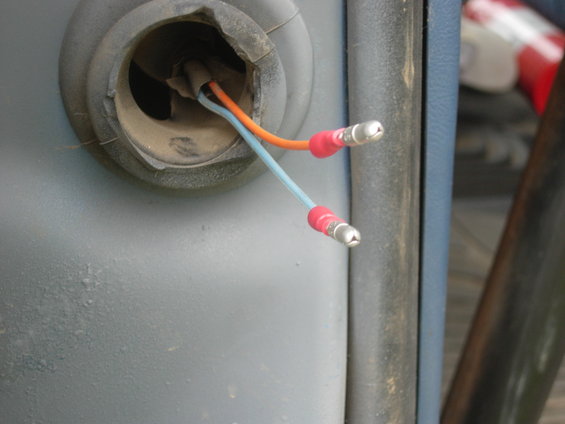

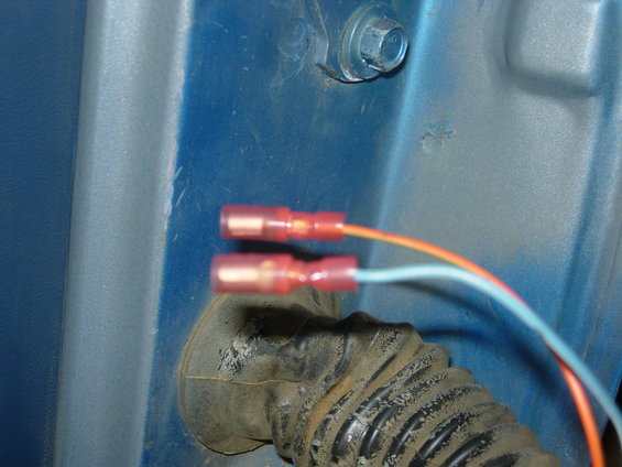

to remove the pins i just tap on them from the bottom and pull them out. i was going to drill a hole through the end of the bolt and put a pin through it to make sure it wouldnt come out, but thats not a issue. as far as wiring i just spliced some connectors on the speaker wires running through the door so i could easily unplug them.

JB Wrote:ive done this. all i did was cut the pins out the stock door hinge. its been a while and i cant remember what size bolt i used, but i had to drill out the holes a little bit to get the new bolt to fit. then i just bolted it back up and aligned the door. i can get pics tommorow.

Did the exact same thing as JB. I tapered mine with the ol' angle grinder to make it easier to drop in. Here's some pics...
