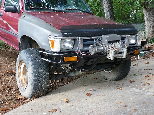

Not mine.. but a friends. He wanted a winch mount bumper - he went with us to Fawl Crawl and we had the center section done by then, but finished the corners today. Considering this was our first Yota bumper it turned out well I think. Here are some pics of it from today. The yota frame rails sit really low and we had to leave some gaps in the bumper to allow air flow to the radiator. We were also able to use the factory blinker lights between the tubes.
Nice work!!!:notworthy:
the bad part about the yota bumper is the crappy stock mounts.2 14 mm bolts and 4 10 mm bolts from the factory.We tied the ft crossmember to the downtubes and it now has the addittion of 4 19mm bolts holding all the weight up ft plus the 4 14mm side bolts to locate it only.If he slams into somebody with this new mount they are in trouble as it is not going to give.
