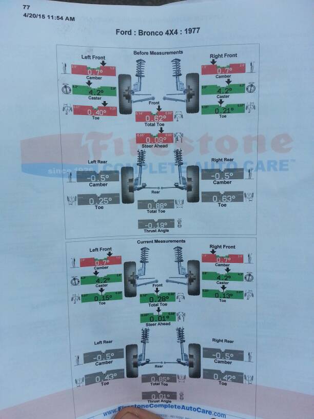

Almost forgot. Got alignment today. These numbers are truly a thing of beauty.
