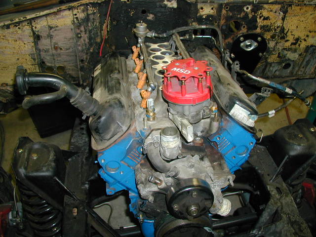

Oops. Guess my memory is not so good. Looks like I forgot to mention that in my build. I tapped the lower intake with a pipe thread tap and used a plug to block the EGR port. It is direclty in the middle of all the lower intake runners and will be a nasty carbon black color. You can see the port right above the distributor cap in this picture. It is smaller than all the other intake ports.

I also did that to a Cobra manifold on one of my 5.0's. I also used the block offs that came with the FelPro gasket set between the head and manifold. I'm sure it helps lower intake air temps, but it really helps when icing the manifold down between rounds at the track.
