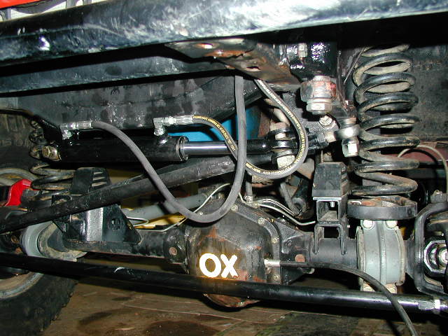

Working on a home-brewed ram assist using the 4x4x2 conversion box, the stock explorer ps pump, and a surplus center ram. If that works out, I'll be stoked! I'm hoping to elimate a lot of feedback that gets transmitted from the trail to the steering wheel.

The ram works!! I know it the install isn't clean. Gonna work on that next. Just tested it 1/2 an hour ago.
My 'kit' is a homebuilt special. I had a Surplus Center 2.0" cylinder lying around. Ordered some hose and fittings from them and drilled and tapped my 4x4x2 box. I have several housings around (keep breaking sector shafts), so I didn't have much to lose if I did it wrong. I didn't have enough room to attach the ram to the tie rod, so it is on the drag link. Probably not the ideal setup, but that is all I had to work with. I am running 33" tires, so the steering doesn't have a ton of load on it while trying to crawl. But while racing in the fast sections, the steering wheel wants to rip out of my hands. Between that and the cracked sector shafts, I figured this might help a bunch.

watch those low hanging lines on your ram. might want to pull tehm up, even if you put them on a spring for your droop. if you need a cable stat, carolina powertrain makes them there. statesviile ave, just off 85. 1 block north.

I am running 250 psi in the front and 230 in the rear. I don't have any nitrogen at the house, but I do have a bicycle shock pump. So, it has air in it- I didn't tell the Bilstein guy that. ![]() I will address the ram lines tonight. Didn't have everything tidy. I'll keep the cable supplier in mind for sure.
